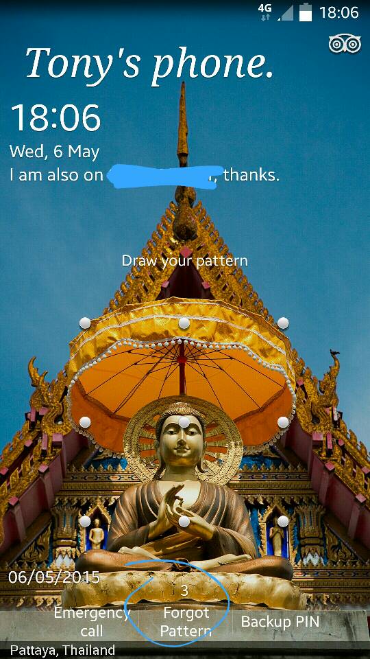

Setting a pattern lock first time, as opposed to a password or pin, you would have been asked to enter a backup pin. Could she have put 1234, 0000, a cc pin # etc. Maybe it was different with Verizon as you say you were there.
Also - on my Samsung Note 3, same vintage as the S4, but still on KitKat, with a pattern lock it will time me out for 30 seconds after several attempts, then I can try again.

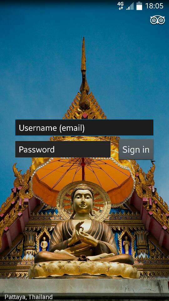

but also I have the option to input a Username and Password instead of a pin, which in Google speak means your mum's full email address and the password for that account.
