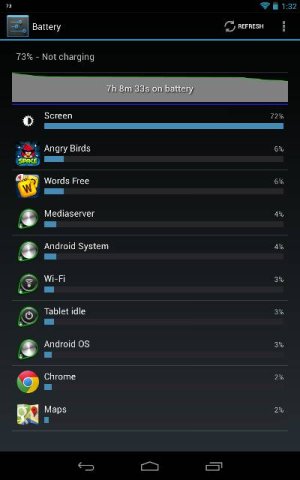

I just updated to 4.2 a couple of days ago and contrary to others, I have seen same or battery battery life. One thing that is definitely better now is charge time. It was taking me almost five hours to fully charge this device and now it charges in half that time. The only issue with 4.2 so far is Bluetooth connectivity but I hear that it will be fixed with the 4.2.1 update.
