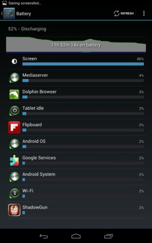

Downgraded back to 4.1.2. Screen is at 50%, WiFi is disabled on sleep.
