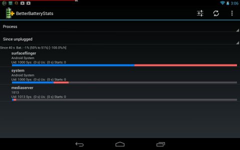

I just did a little research on my tablet. In the settings I changed "Keep WIFI on During Sleep" to "only when plugged" from the beginning but battery lasts for a day with only moderate use. Then I tried Battery Mix widget mentioned here. It showed that WiFi is kept on while tablet is in sleep even though it should be off during sleep. I'm not sure what keeps it on.
Anybody else getting this from BBS? I researched it and have no real clue.
I took a look at my battery statistics when I caught a glimpse of 'surface flinger', then it turned to something else.

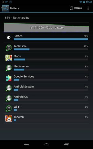

I'm getting good battery life on 4.2 and that includes 4hrs of screen time.
