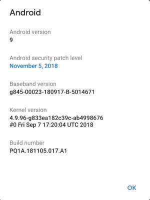

A poster over on XDA was saying the Nov update cured this. I have no way of testing since I returned the phone. I am assuming you are running the update?
Thanks
Thanks
Hmmm... I picked up the November update a few days ago and I'm pretty sure still "Charging slowly" but I'll make a point to check it tomorrow.Screenshot_20181112-191102~2.jpeg
