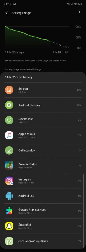

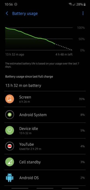

Awesome! Thanks for the tip, after turning off AT&t service battery life is back to normal!
I dont know what happened, but today was a bit of a lighter day, as I had to take the day off from work. I was home for most of the day, and on my WiFi. This is definitely alot better than last week. I'm hoping its able to stay this way with my new Samsung Galaxy Watch, when I get it next week!

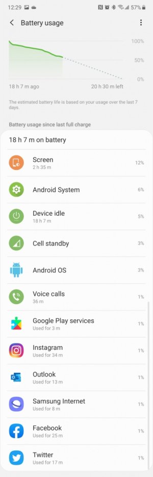

Wow much better day. Thank you all for suggestions and support!

So this is a good sign. I will test with WiFi calling turned back on, over the weekend. But it was off over night while WiFi was left on, and I didn't put the phone into max battery save mode. I also watched a couple of YT videos this morning.

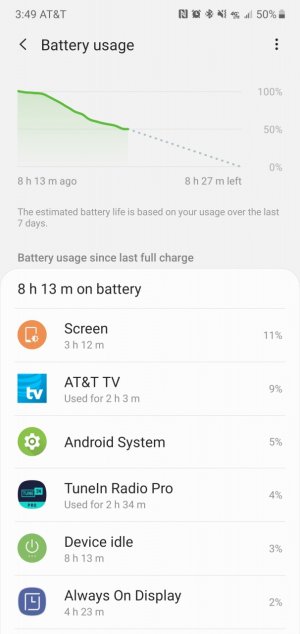

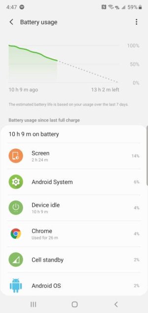

Good thing I checked this post because I also started noticing that the battery wasn't as great as others were saying. I thought it was the fact that I would get weak reception at work but I decided to follow the steps listed previously. I have an At&t Note 10+ and turned off the At&t Mobile Network Diagnostics option in settings, also decided to put some apps to sleep among other small fixes such as turning off notifications for some of the apps that I don't need a notification for. So far my battery has been excellent! Everyone's use is different of course. I do a lot of streaming and in the morning as you can see in the screenshot, I do stream a TV show which consumes a lot of battery but even with that my battery is great. If I wouldn't stream At&t TV then my battery would be at 65-70% at this time (almost 4 PM Eastern). Here's a link to a guide that helps as well with things you can do to improve your battery life. Hope it helps! https://www.gottabemobile.com/how-to-fix-bad-galaxy-note-10-battery-life/
Yes the article you found is the one I discovered to suggest to people turn off mobile diagnostics. Today my battery life remains excellent and I'm beginning to move widgets back on my screen. I'm looking at about 10 more hours of battery life and Android System usage has dropped significantly. I don't have the SOT that many others have which results in longer battery life.

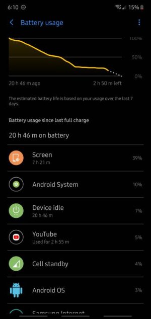

Another fantastic day. I'm really digging this phone!! But good lord do I really spend that much time on Instagram?? Yikes lol

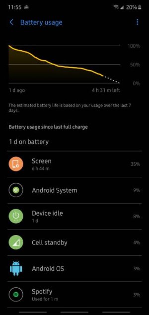

Yup, kind of impressed with how well the standard Note 10 does, now that we finally got that issue figured out. And this is in performance mode without doing anything to try and save battery.

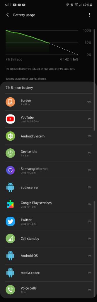

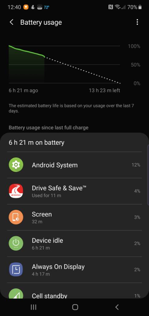

So far, I have to say, I am very please and once again impressed with my battery life. This is where I stand and just took this screen shot.
Android System hasn't been spiking since this past week, and I'm getting a little more than a day on a full charge.
My next test will be to see how a full work week goes.

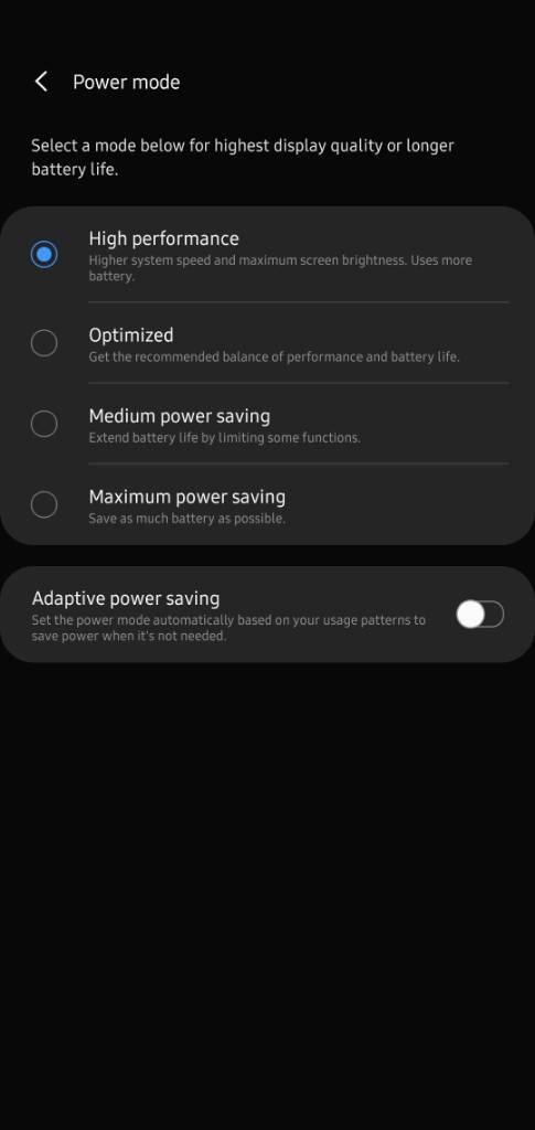

can anyone tell me how to completely turn off power mode until I want to use it? every time I choose it in the swipe panel it changes my settings and that makes me nuts. doesn't matter if I choose to go in via the bottom of the area or only attempt to turn it off. same thing. VERY frustrating. thank you.

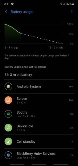

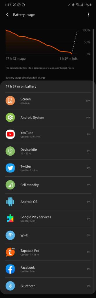

Seeing the same on my Note10+ now. Currently 34% battery with screen at 13% usage 3 hrs 32min and Android system at the top at 15%
Seems to happen around 55-60% battery. Like, takes a LONG time to go from 100 down to 60% or so, then after that it falls fast.
