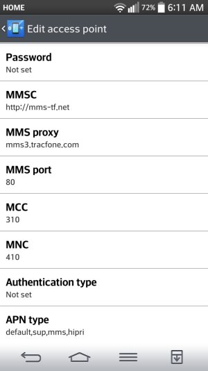

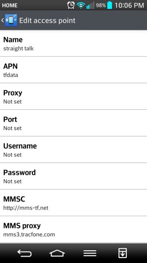

these are apn settings for my unlocked at&t lg g2 using straight talk at&t sim card. i am on kitkat 4.4.2 with software version d80020y(i think this is the latest and includes an at&t update for apn). go to settings>tethering & networks>mobile networks>access point names. hit menu button at bottom of screen then hit "new apn". fill in the settings i posted, hit "save" then restart phone. after that double check to make sure nothing has defaulted to at&t settings. hope this helps
