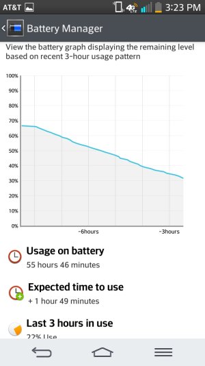

It still happens to me sometimes, and I still haven't figured it out. In fact it just happened this morning, as seen in the attached shot. This time though, I knew exactly what I was as I could track back on the time line. My alarm had gone off, and like every morning, I picked up the phone and checked the market and other news headlines on the web. That's it.
As always a reboot stopped the excessive drain.uploadfromtaptalk1392264642836.jpg
