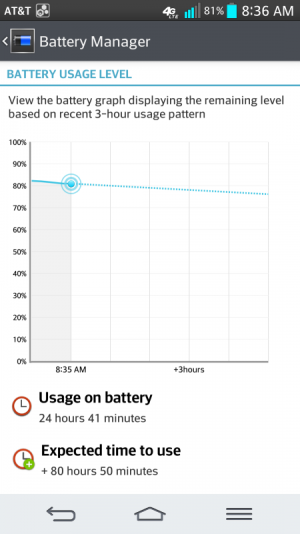

I've been getting some insane good battery performance lately.
normally i can go 4-5+ hours from full charge and stay at 100% with little to no usage and then once it breaks 100% it will decline at a normal rate and i'll get a day and a half.
sometimes it doesnt stay at 100% so long and declines a little faster but still getting morning to evening usage. so i would tell most not to watch the battery so much if the rate varys now and then and you'll still get a days+ work out of it. i dont think it's a phone defect more than there is some process running and it varies at times but cant say what triggers it... signal strength?
My last 24 hours pretty has been light usage, take a few calls, texting off and on, my exchange and yahoo still notifying me all day of emails and i knock knock checking emails throughout the day as well as pull up apps and it went through last night and maybe took 4-5% drain while sleeping and woke to find it still in the 80s!
The best battery on a phone i've ever had. only thing i did was disable the bloatware since I got my phone, slowly finding more to disable. and i dont run wifi or bluetooth or nfc cause i just dont have a use for it but otherwise i run everything else. at this rate i should still have battery going into evening.

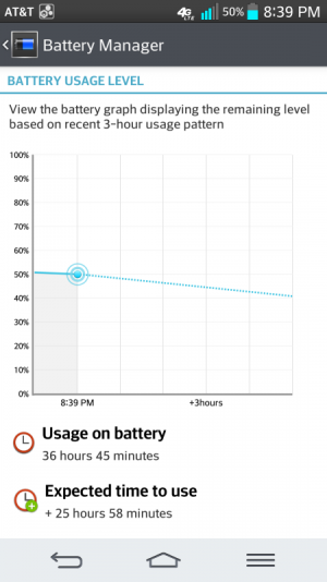

12 hours later from my morning post... light day but filled with calls, texts, emails, chat on beejive, photos taken... and still 50% left. been very impressed with the battery on the phone.
