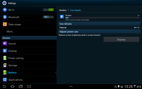

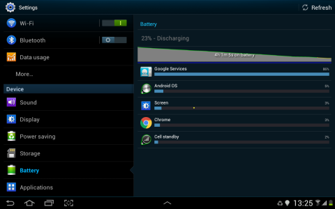

Hi,
I'm not the original poster, but I had the same problem, starting a few days ago. The battery usually lasted a whole day without problems. Now, it barely last half a day.
I tried to uninstall or disable a bunch of apps, disable location services and I restricted background data. Nothing changes (or only get worse).
My device is a Samsung tablet GT-P6800.
Here are the screenshots:
The battery was at 100% when I unplugged the device, so 77% of the battery was used in 4 hours!
Any tips on how to fix this problem would be very welcomed.

Welcome to Android Central! The Google Services drain issue can be difficult to troubleshoot, because other apps can utilize Google Services as well. So the drain might actually be due to some other app, not Google Services itself. Unfortunately, this may require you to uninstall apps one by one until the problem goes away.
I had the same issue recently! After completely shutting off my phone and letting it sit for a couple of hours it seems to have returned to its normal functionality. I hope this will work for everyone else.
I've had a similar problem. For the last 5-7 days, Google services has been eating my battery life at a ridiculous rate. Sync is off, location off, nfc off. Battery life on my s7 was great until this week. I'm so sad 😟
I'm experiencing the same problem... Have even created a topic here. My phone is a Samsung Galaxy Ace 2, and no matter what I do Google Play Services is taking close to 85% of battery. I noticed also that checking the battery details, phone is almost all the time awake.
I believe there is no much that can be done, seems like a problem with te Google Play Services. But, the strange is that I observe this only on my phone (running an older Android version), I also have a Samsung tablet that is very recent, and even though the same Google Play Services version, battery consumption is insignificant.
Thanks for your answers.
I tried Airplane mode. I activated the airplane mode just a couple of minutes after turning on the device (which was completely turned off while the battery was charging): the battery consumption rate was very low, back to normal (but of course, I couldn't do much with it). I disabled the airplane mode, and the battery usage rate went up again very quickly, AND stayed up even when I turned the airplane mode on again.
Following an advice found on another forum, I installed a wakelock detector to try and detect which app maintain a wakelock: it was first Google+, so I disabled it, then Chrome, so I uninstall it. It's now showing Gmail...
I won't have much of a phone or tablet left...

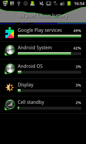

For me, Google services is causing almost all of the battery usage on my phone.
Google Services - 94%
Android OS - 2%
cell standby - 2%
screen - 2%.
In addition, I keep getting crashes of Google Services. I get messages saying that it's not responding, and wanting me to close or wait. Sometimes I get the option to report, etc.
I deleted Google Services and then reloaded it by trying G-Mail, which won't work without it, and then using the option it presented for "getting" it.
But I'm sure that just downloaded the latest version, which, according to some, has a bug causing this issue.
If this is the case, I sure hope Google rolls out a patched version soon! My phone's battery dies in a couple of hours from full charge now, and stays quite warm to the touch at all times.
