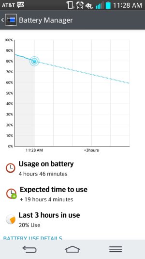

This is what you should be expecting from this phone:
I have Exchange and K9 both polling emails. I have gmail syncing. I have Google Now ON. I have Location Reporting OFF.
I mostly text and browse the web.
The second half of yesterday I saw life similar to this. Today it appears to be trending closer to the frustrating life I had at the beginning of this saga. Here is where I am right now.

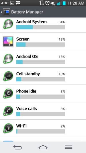

Android System is down from the mid 40s yesterday, but still seems high for what everything is saying
View attachment 91815View attachment 91816
Do you have Better Battery Stats? That might help by showing us the Partial Wakelocks.
And it is kinda confusing, but the Android System that is showing the 34% above in your picture isn't a bad thing necessarily. And it doesn't mean that IQ is back. This Android System is the honest to goodness Android System.
What we need to find out is why, even though IQ is off, your battery is draining. This is where Better Battery Stats would help.
