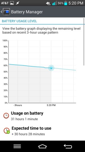

Look at screenshot in post 31 above. I am a moderate user (many phone calls, many texts, some calendar entries, 50 + emails a day, minimal browser use). The last 5 days the phone went on the charger after 14 + hours and was at 50% or more!

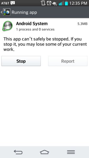

Ahh I see... it was in Android System... thanks. Found it and stopped it. We'll see if it saves more battery.
It should be here:
Settings>Apps>Running>Android System>Stop> Scroll down and Stop Carrier IQ.
(And it will come back on after a reboot.)

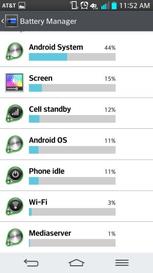

I live in Columbus, OH. The only time I struggle to get good signal (in my entire cell phone life) is in Ohio Stadium when 100,000 other people are trying to use their phones at the same time. I haven't done a factory reset on my replacement device yet. I did turn WiFi OFF yesterday afternoon and ran the battery empty, then kept it off and recharged it to 100%. I unplugged it this morning at about 6:30. I've kept WiFi OFF today, and plan to for this battery run as well. At just past noon today (sent and received about 5 texts each way, no browsing, no updates of twitter, or other apps, email notifications off, and one update of the weather app on the homepage for a total of 10 minutes of on screen time) I'm still at 100%. So I'm encouraged so far. Though just checking now, Android system is at 52%. That seems a bit high.
Don't worry about Android System usage. Your phone's battery is doing great today.

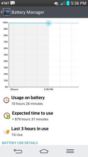

Is this more the kind of battery life I should expect?
To be fair, this is after about 15 minutes of on screen time involving about 15 texts. But I'm happy so far today nearing the 11 hour mark since unplugging.
uh yep :)

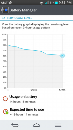

this morning i took it off charge about same time 6:30... the first 5 hours i knock knocked the screen about 20-30 times to check everytime i had a notification come in thru my exchange and maybe glance at the email and maybe one or two texts and it stayed 100% until 11:30. friend IM me through bejive and chatted off and on for a couple of hours and knocked about 10%. after that just some moderate use and 9:24 pm I'm still at 61%.
No way I would get that on my Nexus 4 and would be pretty much drained at this point... so i am pretty happy with the G2 battery. i can goto sleep and imagine i wouldnt lose much battery through the night and probably have 50% left at 6:30 and handle another day like today. I'll probably charge it tonight but just nice to see the extra battery if needed.
Good luck in testing it and putting more load and see what it does.

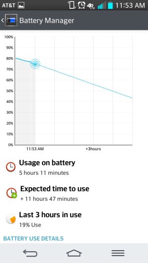

My phone usage hasnt really changed much from yesterday except maybe for a long call but my battery seems to go a little bit more when not in use?
Keeping an eye on it with NFC enabled and then try to see if difference with it off. I didn't think NFC would make any difference buy maybe.
