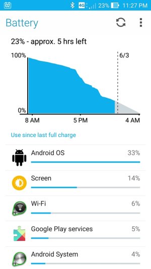

This was my 2nd drain. My house causes mors drain due to a weak signal. Around town it seems to be better.
If that is what it is related to, Asus should be able to fix it without having to wait for 5.1 or later because my Note 3 is on 5.0 and I get 7 hours screen on time over a 24 hour period on a battery that is over a year old. And the Note 3 has a slightly bigger display and I use it much more intensively than just email and internet. To be fair, the Note 3 battery is 3200mAh but with the other factors, it should be about even with the Zenfone 2.

I'm seeing the wi-fi battery drain issue as well. Wi-fi is supposed to use less battery than mobile data in the first place, so this clearly shouldn't be happening. I've seen similar several threads over on Asus's own ZenTalk forums. I'm fortunate in that I have unlimited data on T-Mobile, so I can just turn my wi-fi off--but this clearly will be a problem for those who don't have unlimited data. Hopefully Asus recognizes this problem and corrects it quickly.

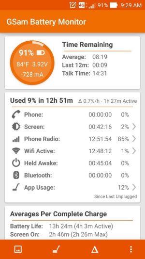

Here is my battery from last night. I used the phone on the forums and hangouts before bed.. Surprisingly very little drain over night.

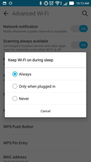

Have you tried adjusting the advanced Wi-Fi settings? This might help.

I haven't adjusted that--I normally keep that set to Always on every device I have, and no other device has this degree of wi-fi battery usage.

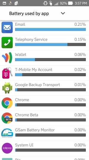

Mine's getting worse. I had wifi off, a good data signal, and turned the screen off with no apps running as soon as I unplugged. 45 minutes later turned the screen on and had lost 8%. Verified in both the built-in battery stats and GSAM that no apps were using up the battery and the screen was off the whole time.
So what shows as using battery ?

Android OS is the only thing showing. And under the app power usage details, the highest usage is email at 0.21% (note that is not 21%, but 0.21%). Here are the screenshots I took:
Android OS using 33% absolute battery. :-\ Screen on time only about 2.5 hrs.
