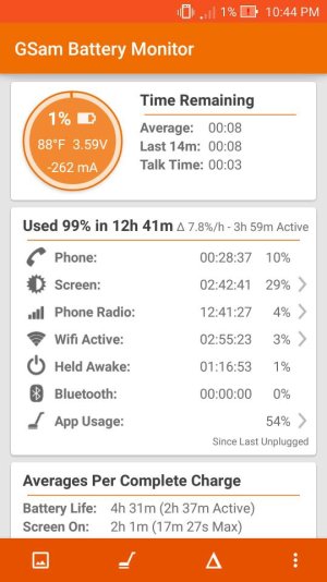

My first 10 hours on battery have been bad. I don't want to judge it yet though on the first cycle. Most of it was overnight with no use. With less than one hour screen on time, at the very lowest brightness setting, using just email and chrome, I'm at 61%. This was after disabling or uninstalling all extra apps and setting it up like my Note 3, which only uses about 15% battery in the same circumstances.
Edit: Btw, in GSAM, it was Android OS that was using 66% and the next highest thing was email at 1.9%. I just cold booted and cleared the cache partition and am recharging now before I leave home (thankful for that quick charge) so I'll see how the rest of today goes and then troubleshoot.
Because this is on 5.0, it still suffers the battery drain bugs that plagued the initial Lollipop release. That's why Android OS is showing such a high percentage. I expect if we ever get 5.1.1 some of that will go away, but who knows?

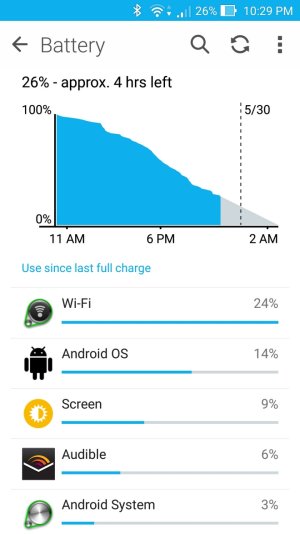

There is a setting in WiFi that you have to uncheck. Otherwise, the WiFi is still on in the background for apps to scan for location. Go in WiFi. Tap the 3 dots. Select Advance. Uncheck the selection.
About Android OS being high on the battery consumption, I think that should be expected. With the tap-to-wake feature, the phone is never fully asleep. I would turn that feature off if I want to check out the difference before and after.
I get 4 hours of SOT on a 550 model easily. I can never get this much SOT on the Nexus 4 or the Moto X (2013).
Yea it's WiFi, I get 4 - 5 hours sot after turning off Wi-Fi and Wi-Fi scanning. I have unlimited data so I don't need Wi-Fi

This was my 2nd drain. My house causes mors drain due to a weak signal. Around town it seems to be better.
