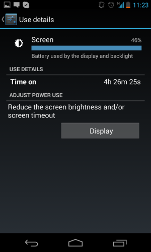

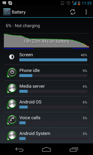

Screenshot_2013-10-17-11-23-15.pngScreenshot_2013-10-17-11-23-05.pngAfter having disabled the Wifi location scanning battery life has been superb.
