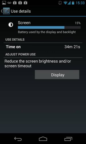

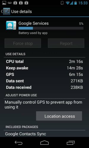

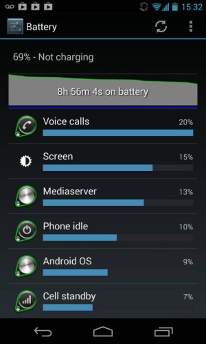

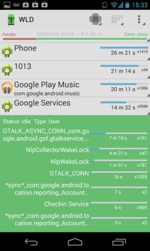

So it was definitely Google maps location reporting that was destroying my phone with wake locks.
The photos are my screenshots with GPS, WiFi, and location history on all day with Google Now enabled.

looking at the image you posted location reporting seems to be the least used.
Are you thinking Google Services = Location reporting???
Google service is a collection of services and one of them is location reporting

My wakelock detector shows that Nlpcollectorwakelock was the biggest hog, keeping my phone from depression sleeping. Through trial and error turning location reporting off in maps seems to have controlled this wakelock. See my images from last time.
Nlpcollectorwakelock is a wakelock used by Google services and not just by Maps, though the latter is the guilty one for overuse.
