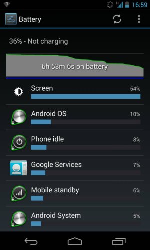

Hey guys, I'm getting this after 4.3, always on Wifi, I feel it's not much ?
Are you guys using some custom kernel or something?

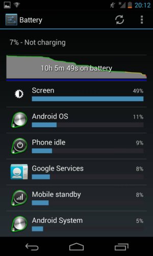

Having recently been updated to 4.3 I have noticed that my battery stats have deteriorated drastically. It appears that whenever the screen is on, the battery is draining at a very fast rate. Since updating I have installed the dashclock widget as well as The apex launcher and notifier.
Do these numbers seem odd to anyone else? Any help would be appreciated!

So it is definitely maps that is the culprit. When I turned off the location reporting and history in maps my wakelocks have settled. Thanks for your help.

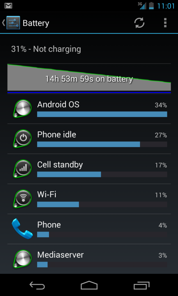

Ditto for me:
And that was a day of letting my phone sit idle. Notice that "Screen" isn't even on that list (it was next after Media Server at 3%). Power cycled my phone, and the problem seemed to fix itself for awhile, but then happened again, as last night I went to bed with ~30%, plugged it in via USB to my PC, and woke up this morning to find my phone had shut off (battery got completely exhuasted while charging via USB).

That is what I seem to be getting too. Right now I have 2h 50min on battery 89% left. Android OS is using 46%. My screen time is under 2 minutes.
It was fine for 2-3 days after 4.3. But now it is getting worse. Too worse. Even with location reporting off and google search disabled.
Google services needs all the battery for itself, and under it Play Services, Framework, Contact Sync, Network Location.
