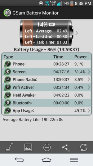

Anyone else have strong battery life the first few days, then bad? My first day lasted 23hrs with 5hr screen time. It has been getting worse ever since. Today I am 8hr, 2hr screen time, 25% remaining. I'm running better battery to see where the usage is...a lot of android system and android os.
Your app usage seems very high, 57.9% of the battery was consumed by this, click on that line to see a breakdown of usage by app.
Yeah I looked into that, it was like 34% from "home" which I believe is the launcher and then a handful of other things for like 4% and under. Should the launcher be hitting me like that ?
So I don't know what to think especially considering some of the other people's amazing battery life. I had Pandora streaming for 6+ hours today at full blast through headphones. Can I please have some input or thoughts on weather or not this is good or bad? I'm kinda da noobish.

Thanks. I was the exact same.Google services killed me and disabled, now it's android system. I will test again tomorrow then factory reset of I have to. I was ecstatic over the battery the first 3 days. Chrome is sucking battery linking at these forums as well. Do you use stock browser?
