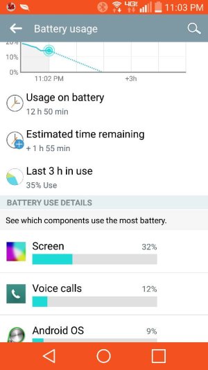

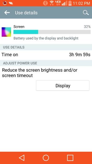

Before factory data reset I was getting about 8 hrs before needing a charge and about an hour of screen time. After the reset last night...check out the pics. My old G2 is back.
