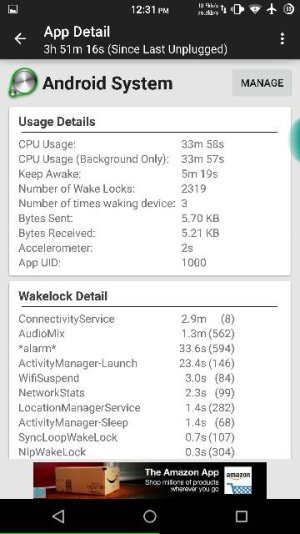

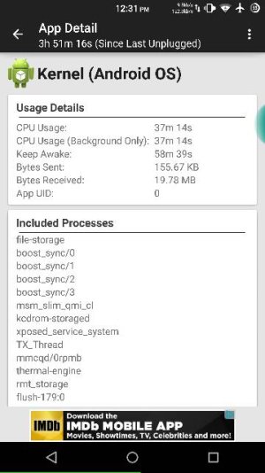

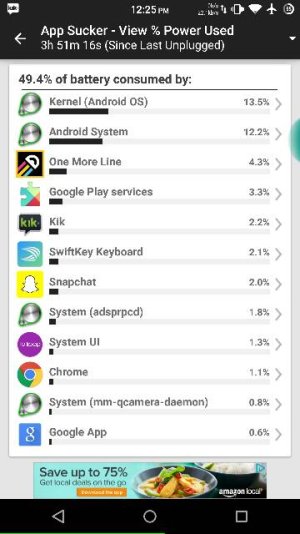

I gotchya, i was just confused sorry about that. I posted an updated screenshot of what's goin on so far. 54% as of now with 1h 9m SOT. I'd there something causing the kernel to use so much battery? I have no idea what's going on.
And these if this helps any.

Seems like a lot of wakelocks for Android System. This might be part of the problem. I need to wait for my phone to get more data as I just topped off charging it 2 hours ago. However, in those 2 hours, I only have two wakelocks for a total of 0.0 seconds. You have a ton for only 3h 51 minutes.

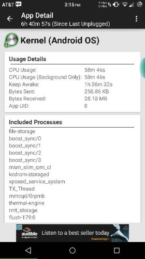

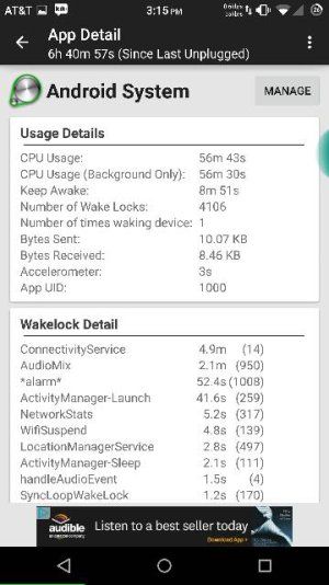

Some updated pictures right before I'm about to plug in to charge. 25% and 1h 52 minutes SOT.

Here is a shot of my Android System with 5h 38m used. Notice how my wakelocks are WAY less than yours? I think you phone is being bombarded with requests so often that it's draining all the power. Not too sure how you will handle this problem.

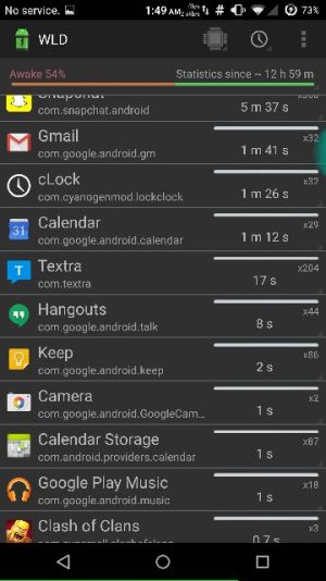

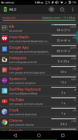

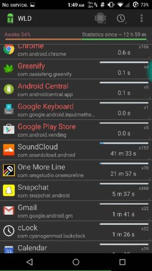

I know your probably tired of me asking so many questions (I'm really sorry, and i greatly appreciate your help), but i just wanted tu ask for one more thing. I posted screenshots of all my wakelocks from an app called Wakelock Detector,but i have no idea what to do now. Amplify isn't working because it says my Xposed framework isn't working, even after i reboot a thousand times, and i just want to find a solution to this problem. So if you could guide me in some direction based on these screenshots, it would be GREATLY appreciated. Thanks so much again for taking time to help!

Jake, I am happy to help you with your wake lock problem. However, Amplify is the only application I know of that will block these. There might be others but I have not researched enough.
Is Xposed activated on your phone? Is the Amplify module activated within Xposed as well? I know there are issues with some modules under 5.0 based ROMs.

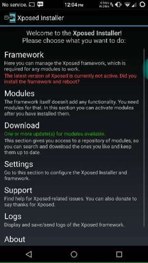

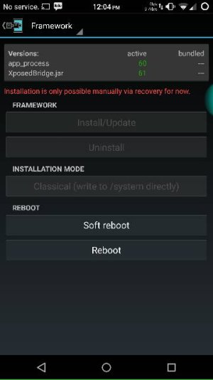

This is the message i get every time. I was told that you have to reboot within the Xposed installer for it to work. Well, even when i do that, none of the modules i have work and it still gives me that message in red, and im not sure why. Am i able to re flash the same exact Xposed framework file without having to wipe and without it potentially harming my device?

Until you get xposed activated you can use greenify to control those apps in question.
After you install greenify go to wakelock detector and select the apps at the top since they are the ones with the most wakelocks, then click on them and wakelock detector will have a button to greenify them through the app.
Greenify will not block the wakelocks but it will kill the apps when not being used.
Figure out how to install xposed manually.
Posted via my AT&T LG G3 Running Illusion ROM
Did you follow the install instructions here?
http://forum.xda-developers.com/showthread.php?t=3034811
