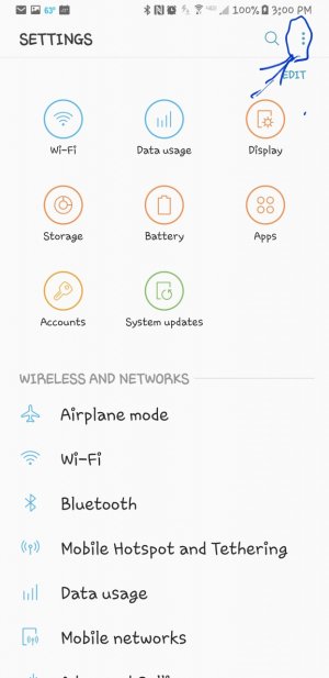

Here's something to check. Make sure your Settings menu is kept in "simplified list" mode. In Settings, touch the 3 dots in the upper right corner to select mode.

The Settings I'm referring to is the phone Settings app with a picture of a gear on the icon, and is usually either on your home screen or in your apps drawer. When you launch the Settings app, touch the 3 dots in the upper right. Your choices are View as a standard list or View as a simplified list. Set it to simplified list. Evidently, Bixby only knows how to navigate the simplified list menu.
You don't see this?

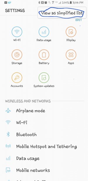

When touch those 3 dots I've circled above, you can change it to "simplified list":
