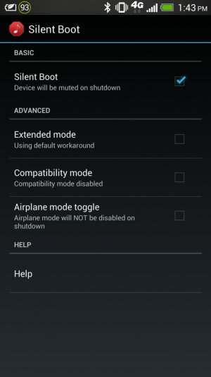

Works well for me as well. This is the only box i had to check off.....
Sent from my HTC One using Android Central Forums
Yeah, Michko's setup worked fine for me...sorry it isn't working for you mystery girl.

Re: Disabling startup/boot sound - WORKED!
Silent Boot was the answer for my HTC One X plus. (Android 4.2.2)
I had to turn Fast Boot option off for it to work.
(Settings...Power...Fast boot )
Thank you all!
