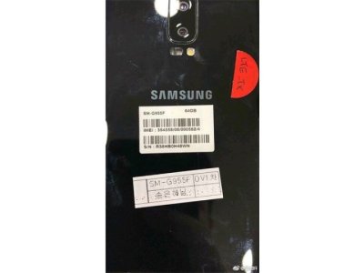

Like the prototype, they should've rotated the whole setup 90 degrees, flash on top, camera in middle, fingerprint sensor underneath.
