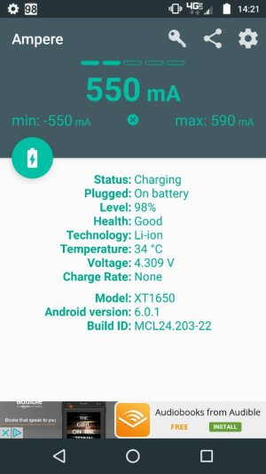

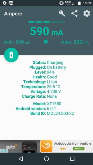

1470258522138.jpg1470258530774.jpg Here's the results from the car charger. It's a 2.0 charger. Battery icon doesn't show as charging at all. But I'm hoping someone can decipher this for me. I truly have no idea what this shows.

It looks like it's charging normally - no quick/fast charging - but still charging.

The car charger is one I had bought on sale for 5.00 off amazon. While it was connected to the car charger it went from 94% to 91%. It worked great on my turbo. I kind of like to have several chargers around just in case. I had planned to use my 2.0 rated chargers for around the house but they are not seeming to work.

The charger is charging - the large number up top is the current rate of change for the battery. If it were losing power, everything would be orange, and there would be a negative sign in front of the number. It is kind of odd that it says "charge rate - none", and 590mA is a slow charge, but it's still going in a positive direction.

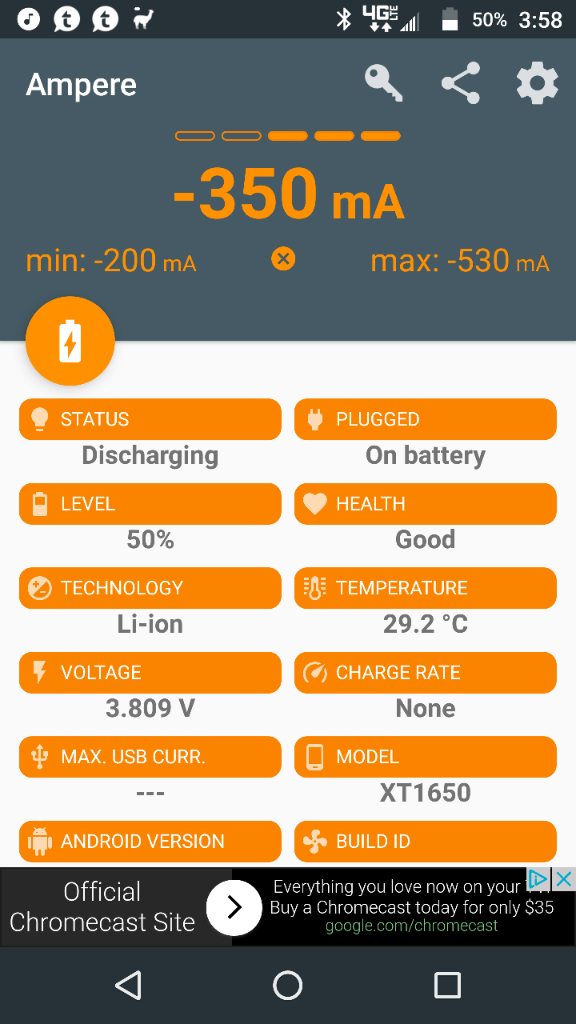

Here's a screenshot unplugged, using power.

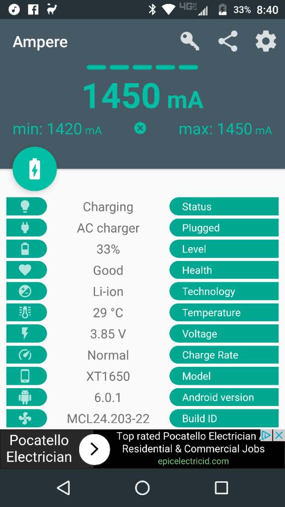

Here's plugged into a QC3 charger:

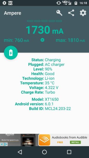

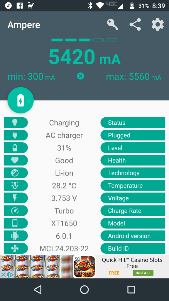

Here's plugged into the stock turbo charger:
