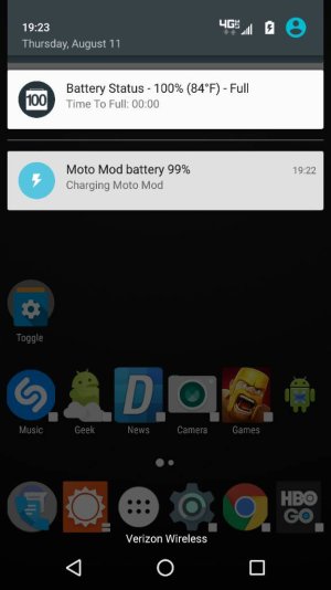

I have to admit I was wrong. Went to local store and the Verizon usb c vehicle charger with fast charge WILL charge the moto mod battery. Here's a screen shot for proof.
On top of that the wall charger usb c with fast charge technology will do the same. I tested that one in the store.
So thank you for sparking my interest and I drove to the store to test them out.

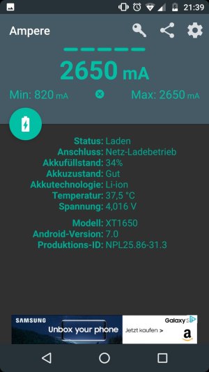

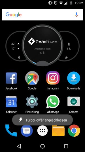

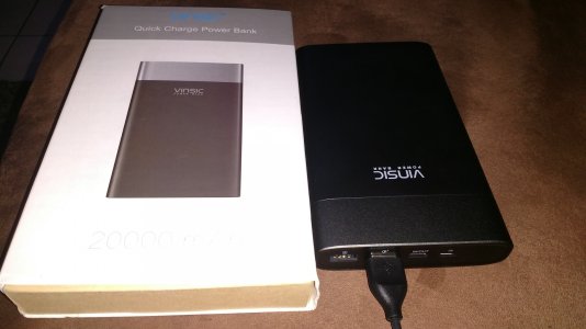

If anybody is still looking for a powerbank which provides TurboPower, you should look for the Vinsic Quick Charge Powerbank. Model Nr. is VSPB303. As an offer you can order it with a Vinsic USB to USB-C Cable for free. At least in Germany.
I paid 33,99€ for the 20000mah Model. I'm quite satisfied with it.
