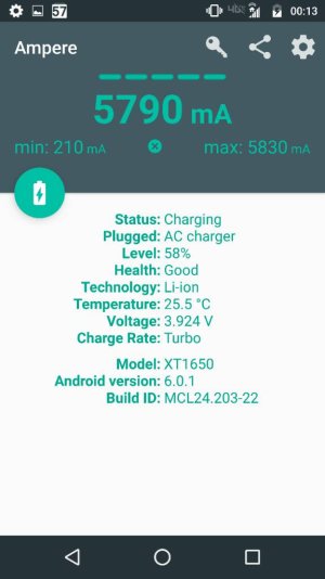

Charge Rate should show Turbo regardless of battery percentage.
As an example, I'm 97% on my Moto X Pure Edition and it's charging at 360 mA but I'm plugged into a TurboPower charger so it shows the Charge Rate as Turbo.
Obviously it won't show turbo on a QC charger, but the speed will be comparable to Turbo. And the closer to 100% it does slow down.

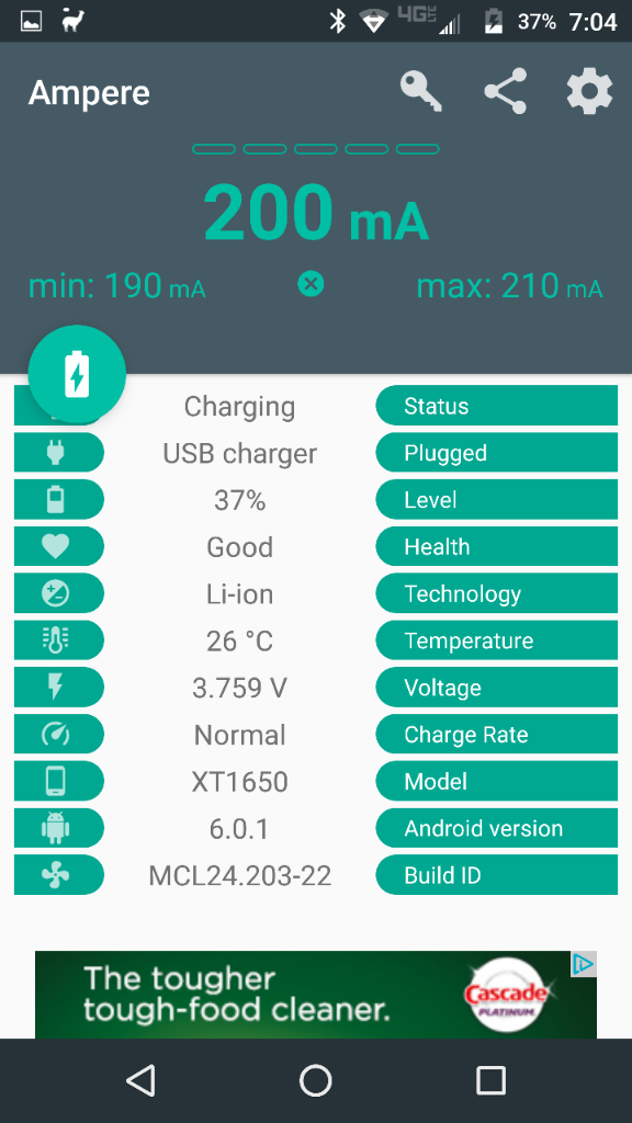

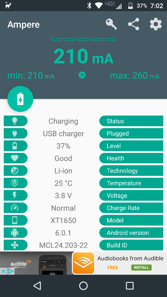

1470285674318.jpgI ran it down like you suggested. No change. In fact I left it plugged in for about half hour and it didn't charge at all. I think my only options will be to pick up some higher powered charging blocks. Was hoping to avoid that.
1470287870359.jpg After trying all the 2.0 chargers for an hour and got no actual charge at all, I give up.
This is the supplied charger. So going to have to look around for something that works I guess.
View attachment 234031 After trying all the 2.0 chargers for an hour and got no actual charge at all, I give up.

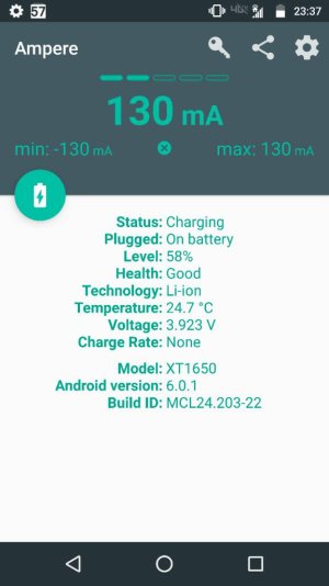

Tried all of my QC 2.0 chargers, all of my standard chargers, and my wifes apple chargers. None of them charged my phone. Also tried the QC 2.0 car charges and standard car charger to no avail. So Im kinda stumped at this point and not sure what to do. In fact most of the chargers would show the ampere screen in yellow and say it was discharging.
The force charger shows an output of 5v/5.7 amp. Anyone have any recommendations??????? Kind of pissed at this point.
