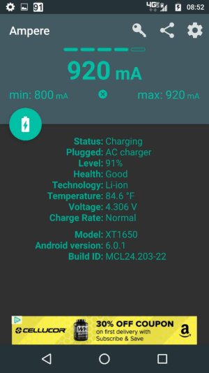

The quickest one I could get was at Walmart and is a Belkin. The charger is not a fast charger. It's an old Motorola charger I I bought when I had a razr Maxx HD. It's on amazon as Motorola dual port charger SPN5689. But good numbers from it.

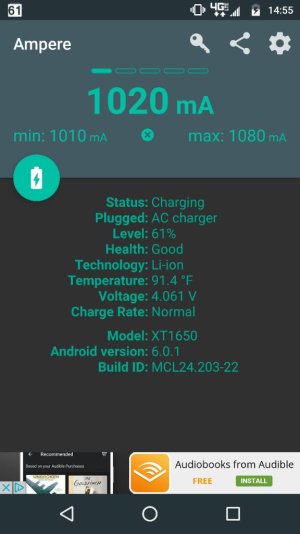

Has anybody found a third party wall and/or car charger that actually triggers the "turbo power" on screen notification? I really don't want to fork over $40 for the Motorola or Verizon branded ones. It looks like this phone does not officially support QC 2.0 or 3.0 according to spec sheets - which sucks because I have a lot of QC 2.0 chargers laying around from my Droid Turbo.
This is what I get from a 2.0 car charger. Using a micro USB cable with a USB micro to USB C connector. Good enough until they come out with a car charger that will turbo charge.
