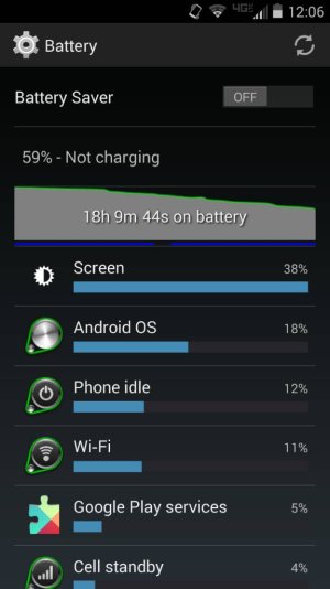

I've tried just about everything to improve battery life. I've restarted the phone; battery life remains the same after the restart. I've wiped the cache partition in Recovery; no noticeable change in battery life. I've turned off using Hangout for SMS and switched back to Messaging, after reading that the latest version of Hangouts was causing problems when used as an SMS client; there was no noticeable change in battery life. I've turned off Google Now and turned off location tracking and location history; there was no noticeable change in battery life. I've even factory reset twice, and battery life always goes back to what it is now after a day or two, if not right away.
Things I haven't done? I haven't turned off data sync, because one of the reasons I wanted a smartphone in the first place was so that my Gmail (in particular), calendar and contacts would always be as up to date as possible. Even with older phones I've had, though, when I've used something like Tasker to automate switching data sync off for 15 minutes and then on for a couple, it never had any noticeable affect on battery life. I haven't rooted; I rooted older phones, because they needed root in order to work well, but I'd rather not have the phone rooted if the phone will perform well (and, of course, at this point it's not going to happen anyway on this phone.) I haven't turned off BT, either, because I am using a Pebble watch, both to get notifications without looking at the phone and to keep the phone unlocked with the trusted BT device. I'll stick with the battery life I get rather than not use the Pebble, at least right now (I may change my mind if it gets worse.)
If I take my phone off the charger when I wake up and plug it back in at night, most nights I end up with a phone with about 30-50% battery life left, depending on where I am during the day - how much I drive (drive assist seems to drain the battery more than I see if I just stay home); what the mobile signal quality is. This is with about 2 to 2.5 hours screen on time on the phone. It's good enough for me, but there are times when I would nearly drain the phone, such as when I am driving a lot, or listening to media a lot (most days I do so for about 1:15 to 2 hours a day, with the display off), or when I'm in a place with a really bad signal. So, I just plug in when I can (I have a Qi charger in one of my cars, which is great), and I get through a day just fine.
I'd really like to see battery life go back to where is was on 4.2.2, but hopefully at least it won't get worse than what it is now. I am glad that I bought the Maxx, though, and not the Moto X, because I know I'd be playing battery games with that phone to get through a day.

I have a droid maxx as well and my battery life blows now also, but I think one thing being over looked is the Motorola services that have been updated. I have never seen any of the moto services show up in my battery life area, and I also use Motorola Connect with chrome, which I think is the source of my issues. I think it is over polling home base or something. I believe it ends up showing up in google play services though. I dont have an incredibly high awake time. But it just went from 50% to 3% in 5 hours without me touching it. That should be impossible in any conditions.
For the record 2 my wife also has a Maxx and she has incremental decrease in her battery life, but she uses her phone more now, so its hard to tell how much some of these motorola services are to blame. She was getting 4 days a charge. Now its somewhere between 2 and 3. I feel like my battery just isn't holding up any more.

My biggest beef is that Moto Connect and Moto Services look like Android OS and Google play services in the battery area. If they were it would be brain dead easy to see if they were the culprits.
