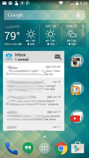

Do you use the droid command center widget?
I upgraded from the Droid Maxx to the Turbo back in April and noticed my battery was significantly worse on the Turbo. I spent some time removing apps, doing a few cache clears, factory resets, and battery monitoring for a few days after each tweak. No matter what I did I could barley make it through an entire day TRYING to conserve battery. During that period, a typical day would consist of ~16 hours with an hour or so of calls and 2-2.5 hours of screen time and the battery would be at ~15-20% left. My maxx would only be at ~60-70% left with similar usage. A little over a week ago I was about to give up on trying to make it last longer and accept the fact that I wouldn't make it through an entire day under heavy use (Droid razr cord hugging nightmares started :eek:). I went through the Turbo one last time thinking 'everything is setup exactly the same' as my maxx was.... except the droid command center widget. I uninstalled that bad boy 10 days ago, and, for me, that was the cause of the battery issues. I'm back to charing my phone every other day :D!

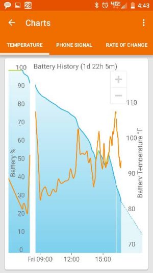

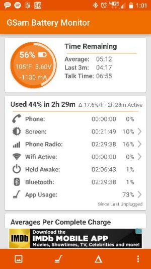

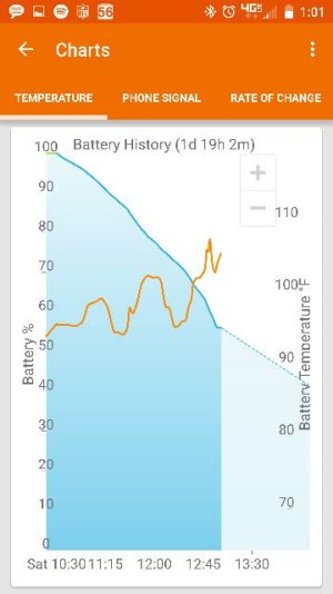

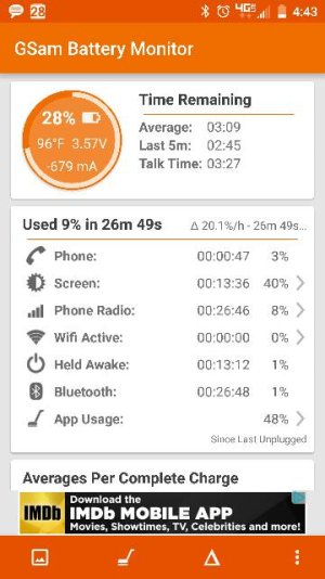

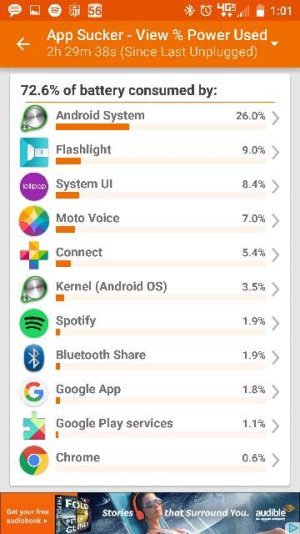

My battery has suddenly turned garbage the past week. What's going on? I cleared cache and all
Here is a better sample. Had it unplugged for 3 hrs and already down half with light Spotify use.
Any suggestions will help as i travel in two weeks and need this fixed or replace d under warranty

Boy, these are always hard to diagnose. It's some app that's running in the background (as well as the flashlight - try not using that maybe?)
But, you have a notification from the NFL app. Unless you really, really need this app, I'd suggest maybe uninstalling/disabling it and see if that improves battery use.
Otherwise, you can always verify that it's some app issue by running for a couple of hours in safe mode (long-press the power off and follow the prompts.) If the phone still eats battery in safe mode - it may be something wrong with the phone. Otherwise, if you haven't done a reinstall after a factory data reset, I think I'd be trying that next (after, of course, backing up photos and videos, etc., from storage.)
Oh, you're also BT connected, it looks like, so maybe it's partly that? It's only 1% according to GSAM, but I'm not sure I've ever trusted that report. When I used to use BT earbuds, my phone would drain about 5-10% an hour more than if I plugged in wired earbuds.
I'll uninstall the NFL app but its never been an issue before. The flashlight hasn't been on so not sure why its showing as being used.

I too have seen a rapid drain in the past week. I am taking the suggestion of disabling NFL mobile. I see there was an update recently and wonder if that is the culprit. Let me know if you find and answer and I will do the same.
Hey, guys, this happened to me too. Battery all of a sudden several days ago just can't hold a charge for a day. I wasn't acting or doing anything differently. Didn't install new apps. Don't think it's NFL, but stock email ("email") app acting weird too. I actually ran out of juice the other night. Never even came close to that before. Any insights would be great. I also installed that newest 23.21.44 yesterday thinking it would help, but it didn't.
EDIT: UPDATE 10-12-15. Logged out of the crappy stock email app and don't use it any more. Thankfully, everything seems to be back to normal with the battery. I narrowed it down to corrupted thingamajig. (have no idea what it was, but stopping email did the trick). Thanks for the help/recommendations.
If the stock mail app is being problematic (and it is a crappy app), try a good third party app from the play store to see if that solves the problem. (Also remove your account first.) Even the gmail app now supports POP3 and IMAP mail accounts, rather than just gmail accounts, and is already on your phone, if you're not big on third party apps.

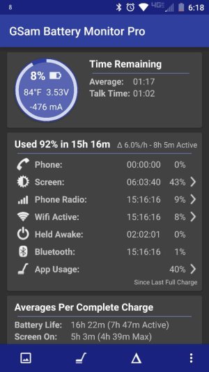

My battery has been really disappointing since the lollipop update. I usually don't complain about it, but with a battery this big, I expect more. It just keeps getting worse. I've cleared cache and done the FDR. I am running the exact same setup as before the update,and the exact same apps are using the battery the most, I guess they are just using more of it. I have to throw it on the charger every day when I get home to make it through till I go to sleep. It feels like the same battery life from my first gen moto X.
