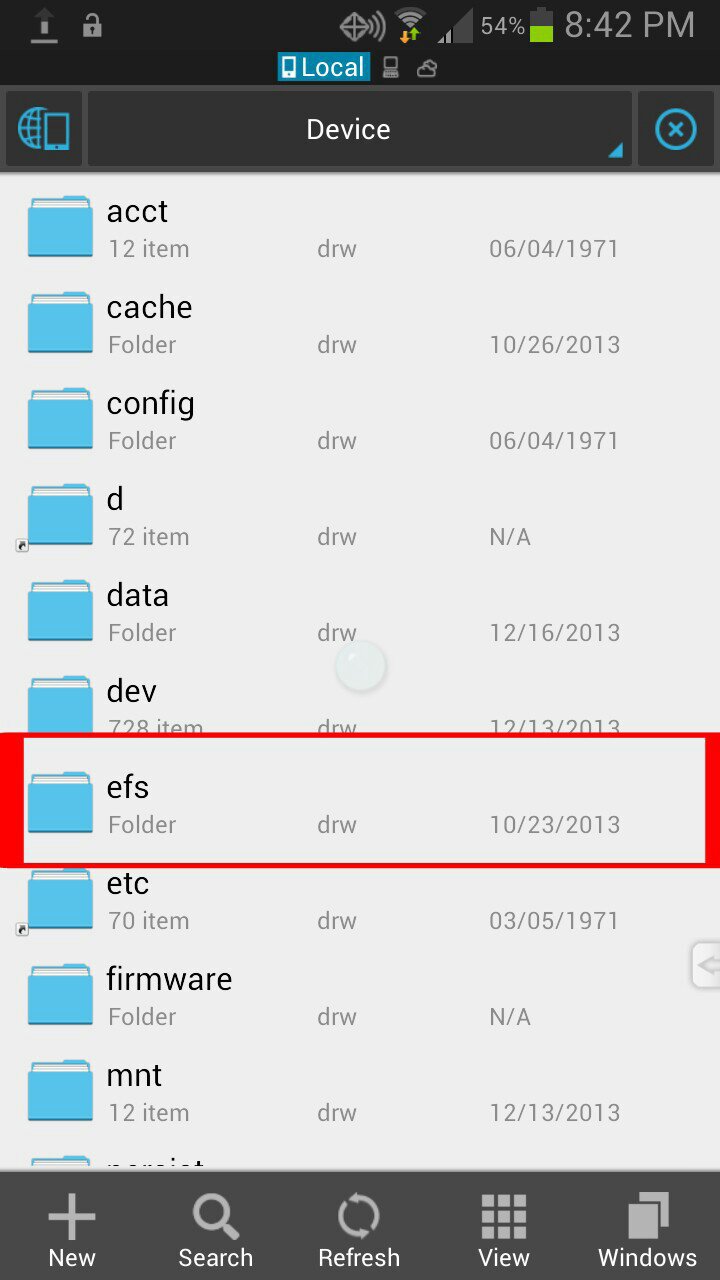

Could you explain to me why and what the EFS message is anyways? I don't know why I got it.

EFS is a special folder in the Android operating system
See here for various explanations about what it contains and how to make backups.
