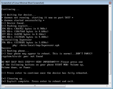

Worked here just fine. The only thing that got me was the MYGROUP in all caps. My fault for not reading the instructions closely enough. I actually had to use it about 5 times because I was trying to flash my Bionic to cricket, screwed it up a few times and had to factory reset a few times. Funny thing was when I did the factory reset before the successful flash I'd lose root. After it was successfully flashed to Cricket I had to do a factory reset and the root held. Thanks for the easiest root ever, I think this was even easier than the old GingerBreak exploit I used on my last phone, an Optimus C.
Worked great!! After about 45 tries (my fault of course). Just make sure your usb drivers are installed correctly and BAM! Thanks for all the hard work devs
Thanks. Great exploit. Definitely worked. I received the invalid IP but you basically need to restart phone and access point to get them connected to the router.

I'm having trouble with this one. The procedure appears to go well, even the the vibrating reboot followed by the reboot after cleanup, but the Superuser app says "su binary need to be updated" and root checker says "no access".

Is there a trick to pressing one of the keys at the correct time? I've tried 3 times now and by the time I see the message prompting me to press the power/vol up/vol down key the phone is already re-booting. How the heck did you guys get the key pressed in time? Must be my 60 year old reflexes, not quite as spry as they used to be! :'(
Had virtualbox on my laptop so i figured I try again. every thing looks good and the phone jumps through all the hoops but still no root access.

Finally! Success! I didn't doubt the method, but I wonder why it didn't work for me. After multiple failures using the factory wipe so the procedure could root a fresh phone I finally ran RSDLite5.7 and through the fastboot menu replace the install image with cdma_targa_9.8.2O-72_VZW-22_cfc.xml.zip. After doing that the root procedure worked the first time.
