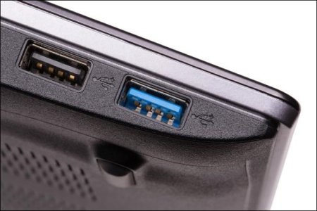

Charging from a PC will always be extremely slow, especially if you are using a USB 2.0 or 1.x port. A USB 3.0 port (it will be blue on the inside) will charge twice as fast as either of the others. On newer PCs, at least one of the ports ON THE BACK, not the front, will usually be a 3.0 port. See USB - Wikipedia, the free encyclopedia

Look at each of the USB ports on your laptop and see if one of them is blue on the inside. If yes, THAT is a USB 3.0 port. The one on the left is USB 2.0, the one on the right is 3.0.
If your laptop has a yellow port, that one is powered up even when the laptop itself is off.

All three are 2.0 in that case.
USB 2.0 ports put out a maximum of 500 mA; that's a bit more than a third the power output of the standard Nexus 5 charging brick. At 500 mA, charging will be VERY slow if your phone is turned off and negative if your phone is turned on and actually doing anything.
None of this has changed; it is highly unlikely that you were getting any different results before the Lollipop upgrade.
USB 3.0 ports put out 950 mA (the stock Nexus 5 brick puts out 1.2 Amps or 1200 mA). USB 3.1 ports are capable of even higher outputs, 2 amps and more.
