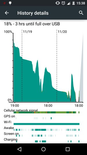

During charging, the moment I start using phone, it charges much-much slower than that before update.
See my battery discharge pattern.
  1. When screen is on, battery drains heavily.​
  2. During night, almost no battery discharge, an improvement.​
  3. Wi-fi is shown on throughout the duration, it was turned on only during night. But breakup shows wi-fi takes only 6% of battery, so that should be ok​
  4. Before update, breakup reported screen as taking most battery, now it is around 20%, same as Chrome (I used browser heavily)​
