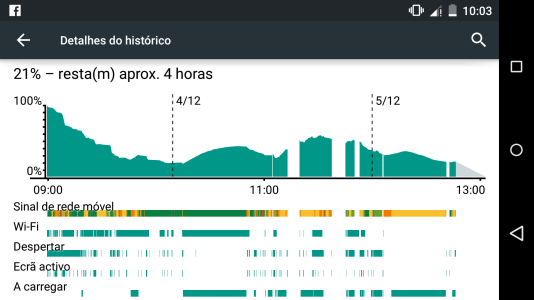

I'm sending it to warranty today because it simply does not charge as you can see by the battery chart! ...:(
Notes on the chart:
1 - To get to 100% it had to charge switched off on the wall charger for 25 hours.
2 - On the first day I used the phone "normally" but with some caution.
3 - On the second day I left it on charge in the wall charger but left the wifi on because I forgot ... but it's a strange curve...
4 - Notice the strange battery drain when turned off on the end of the 4/12
5 - What made me decide to send the device to warranty is the charging overnight in the day 5/12... It simply didn't charge a thing!! :(
Let's see what LG has to say...
Thank you all for the opinions! :)
