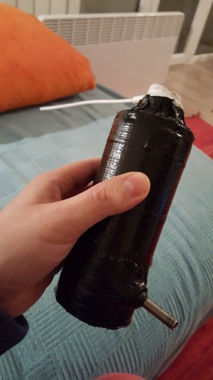

I was just about to go to Samsung fast repair center in my city because of that problem I've been struggling for days and before that, I try just one another thing, blowing the phone's micro USB port and charger cable micro USB jack with preassurised air. I used my "ghetto" compressed air duster can preassurised with ordinary bicycle pump. Fast charging starts immediately.
It is highly possible that phone's port pick up some piece of cotton or dust from the pocket and block the cable to get in completely. Another cables I've been testing before (SGS3 and some LG cable) now Fast charging too.
Caution! Don't recoment this kind of contraption I used, better by one with butane propellent because preassurised atmosphere air contains water and water is not good friend with electronics. I risked ;)20160218_002226.jpg
