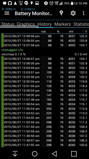

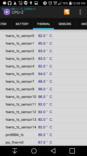

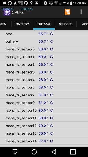

It cooled a bit before this screen shot. Will try to get it right when it happens next time. Ambient is 79F,and it is overcast but I am using mobile hotspot. I unplugged and re plugged it in a little after it dimmed the screen
uploadfromtaptalk1435432594858.jpguploadfromtaptalk1435432602504.jpguploadfromtaptalk1435432607318.jpg

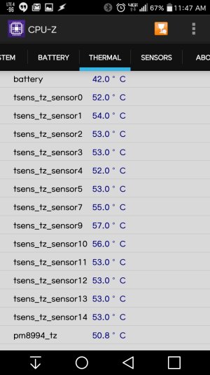

This is what I see under normal usage like browsing, email, Tapatalk, hangouts, etc.
