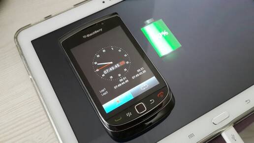

This morning i decided to record the time it takes to charge my note 10.1. With a room temperature of about 28c, using standard charger supplied, tablet turned off. I managed to get a 7.5hr charging time to reach 100%.
Is this normal?
Is this normal?
I noticed that you are using the stock Samsung charging cable. I used the app Ampere to show me the best cable for charging and I found out that the stock charging cable is horrible for charging. I started charging my tablet using only an LG cable and my charging time was down to 2-3 hours or so. I also use the stock charging brick/ac adapter. The app lets the user see the charging current, the user should then swap out cables until he/she finds the best/fastest charging cable. I am not associated with the app in any way shape or form.
Is this normal?
I had this problem too before and found out 2 culprits. The charger pins has bended and just need to bend it back, so USB cable sit correct. DONT HAVE CHARGER PLUGGED IN WHILE BENDING IT BACK!
Samsungs USB cable is "broken", I got 3-4 of it from old Samsungs devices and only 1 is still working for charging correct.
Use Galaxy Current app to measure while charging the tab and find u culprit for the slow charging.
