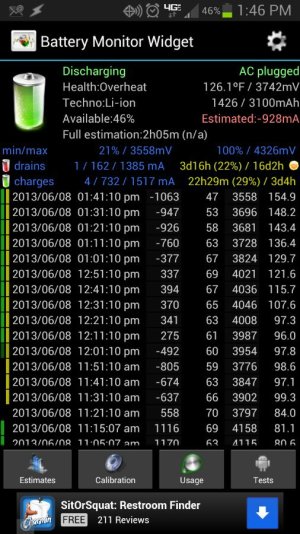

When you say overheat, how hot is it getting? My note 2 got to about 154?F before.
Re: galaxy note 3 overheating
Damn that is hot
