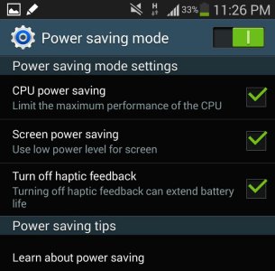

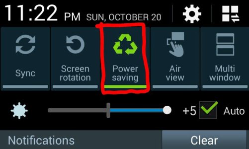

Sure thing.
Step 1:
Open your notification bar.
Step 2:
Tap and Hold the Power Saving button. (Make sure it's green so that we know it is on)
It will open up the power saving options.
Then just make sure that your power saving options look like that. :)
Hopefully it works for you too!
Sent from my Samsung Galaxy Note 3 - SM-N9005 using Tapatalk 4
