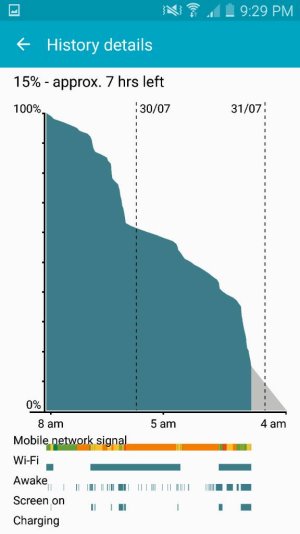

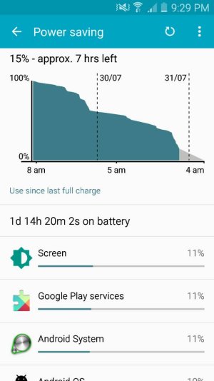

What do you guys reckon is keeping my phone awake? I know this is pretty good battery life but just out of curiosity I wanted to know. I have location off and always toggle wifi and data off and on when needed. These scree ****s were taken with a SOT of about 4hrs. Thanks

Man, I'd be really happy with that awake time compared to mine. :/ lol. But I manage 4-5hrs SoT, so I guess it doesn't really matter...
Yeah not too bad. I haven't got any more then 5.5hrs of screen on time but that is pretty impressive since the note 4 has a qhd display. It's still impressive what samsung can pack into these phones.

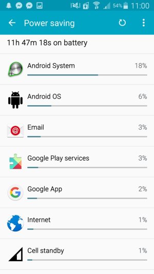

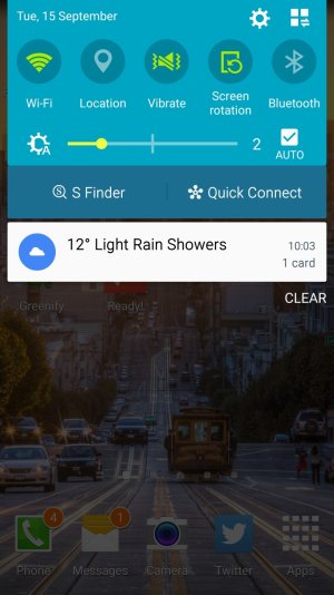

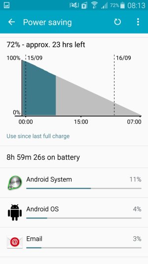

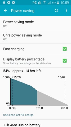

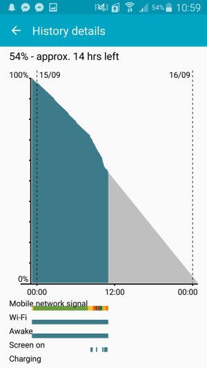

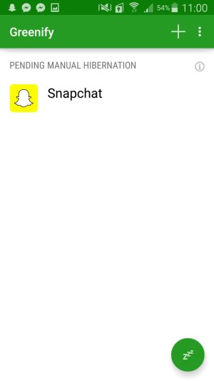

Hi there guys, first time posting here, but I've got some concerns in regards to my newly acquired Note 4, the device itself actually came with Lollipop 5.0.1, I love it as it was an upgrade from my HTC One M7 which was basically dead. This phone is great, but the battery life has been concerning me a while, whilst I'm using it, the battery life goes down as I'd expect, however when I'm asleep for 7-8 hours, I'm actually seeing drops of 20-30%! I had a 28% drop last night and I have no idea how or why, my girlfriends S4 has a better battery life. I've got the screenshots here and was hoping that you guys could help me, because I think I'm struggling to see beyond an hour of screen on time and that's only with using the usual media apps like facebook, twitter etc whilst I'm out and about. PS. I'm on EE in the UK if that matters at all.
