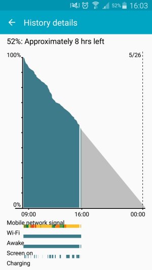

My battery life is good but I need to figure out why my phone wakes up so much with the screen off
Sent from my Galaxy Note 4 using Tapatalk
Just checked Accounts and found LinkedIn, Twitter, and OneDrive syncing. Maybe in my haste to set up and get back to studying for my final last Thursday, I didn't do my due diligence to ensure that I shut off all the background syncing. I'll be monitoring the screen off wakes going forward to see if that helps!! Did leave OneDrive on but checked the box to only have it sync photos when plugged in and on WiFi

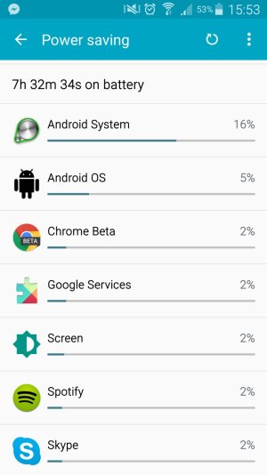

I'm having a battery issue with my Note 4. I'm half way thorough the day and my main battery consuming is Android OS.
This is weird because, ever since I used Android it was always the screen on top.. Anyhow see it below... (I dont have any cleaning bloat apps or bluetooth on or even location.. I do all the saving battery methods)
I assume it's because where i work on the 15th floor, I have bad mobile connection for some reason with my Note 4.
Anyhow I use my Note with brightness on 0 (got use to it and saves battery) so I dont know what to do...
I even use Greenify hibernation.
PS : Think I found the issue.. The 4G connection here is horrible therefore my phone is struggling to find network...
That and something is keeping awake what appears to be 100% of the time. If your network connection isn't good and you're not going to use it, I'd suggest putting it in airplane mode if conserving power is the primary concern

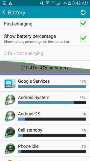

Does the amount of use you get from a fully charged battery GSN4 battery decrease over time? I am assuming so. But my 6 month old N$ has had a dramatic decrease in how long if stays charge literally overnight. My usage has not changed, nor have I changed the apps installed, hidden disabled, etc.
Used to be when I changed it to 100%, I didn't use it much still be at 100% and hour or two later. With my typical use, it would be down to maybe 40% to 50% after 24 hours, now it can't last 24 hours without fallig below 20. When it dropped from 70 to 40 overnight just sitting there. Six hours before this screenshot it was at about 70%. And it went from that to about 17% in three hours of low use. Nothing "extraneous" running that I have any control over (AFAIK.)
I had something called Google Daemon, or Android Daemon or associated with Google Services or Android System with Daemon in the name that was using most of the battery. It let me Force Stop, but that had no impact on battery use.
I am still on KitKat and have been postponing the update to Lollipop for the last month. Could be it?
Used to be when I changed it to 100%, I didn't use it much it would still be at 100% and hour or two later. With my typical use, it would be down to maybe 40% to 50% after 24 hours, now it can't last 24 hours without fallig below 20. When it dropped from 70 to 40 overnight just sitting there. Six hours before this screenshot it was at about 70%
The pictures isn't showing up for me.
