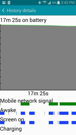

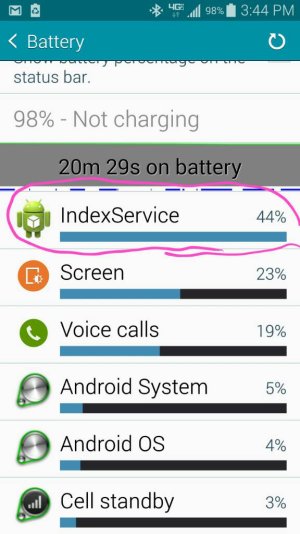

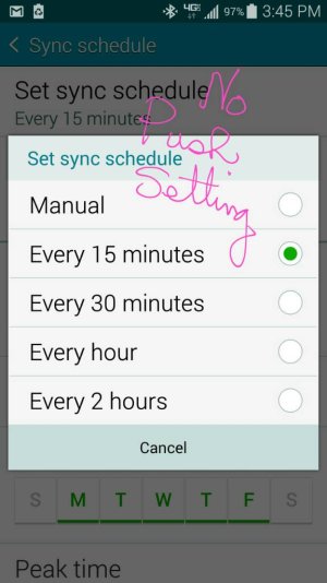

Rukbat, thank you. I am currently using stock email and there is no option of 'push' I had looked for it prior. I also use a Gmail account (have not checked that one) I did try to condition the battery as you stated. Screen shots attached. Thank you to you both for trying to help.

I lost 4% of the battery from when I snapped those screen shots a few minutes ago to now

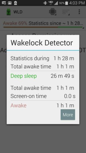

D/l wake lock this is most it will do without rooting. Really frustrated.... As for an average consumer and not techy of Android.... I'm feeling like I shouldn't have to do all these things to make a brand new phone work properly! Please don't get me wrong, as I am Extremely appreciate for the help!
what email service(s) do you use?
The reason I asked is due to the fact that not all email services offer push, especially push through 3rd party email applications (3rd party to their service).
Gmail offers push, yahoo offers push, msn offers push, but I gernally use all of their respective applications, Comcast offers push, but only on their app.

Thank you as I never considered it was the service and not the app.....I use Cox as my main email and that email is very important to me for business. This is so weird as I never ever had problems like this on my Note 2 and never had to use Cox's apps.
unfortunately all android devices have their growing pains, some apps work differently some don't... and when features are removed, it's usually because the vast majority isn't using it (which seems like the opposite, or the developer just couldn't care much for it)...
but when you do get to tweak your phone and get it to work for you, that's the beauty of the device...
Try giving the cox email application a run and see how that affects it, plus using that may also have some benefits and advantages over the stock exchange email app... another thing you can do rather than using the one that was provided by Samsung, you can try downloading the google exchange app from the play store and see how that one works in comparison to the one that you are using now.
One thing you might want to consider doing is transitioning your business email over to a Gmail account.
I usually don't recommend using an ISP's email service for anything other than as a spam account.
Among the reasons, their platforms generally aren't that robust, they don't spend a lot of time optimizing the services for mobile access (even though a high percentage of email is handled by mobile devices) and if you ever change providers you lose the email address.
Since you already have a note 4, I would encourage you to set up a Gmail account for your business, and use inbox to manage it. You can set up your Cox email to forward to the Gmail account. Let your customers know you have changed your address (use the signature function to notify them when you reply, too) and in 3—6 months you will be transitioned over.
Plus that might help you with some of the battery issue you're having. If you have a lot of emails stashed in that Cox account that might be why the indexing is still running.

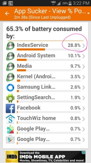

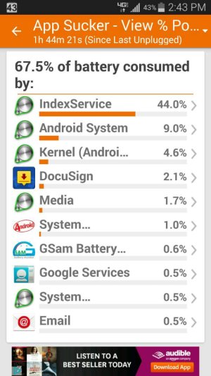

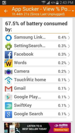

Stats from Gsam app. My phone still continues to run "Index Service" and seems to be the most taxing on my phone.

So I turned off the phone, pulled SD card, restarted. Weird, as now Gsam doesn't show the "Index Service", but when I go to Battery in settings, it Does still show it.
