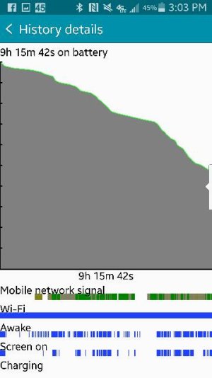

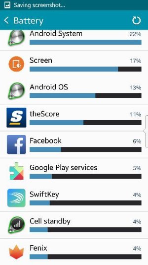

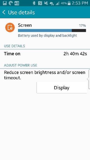

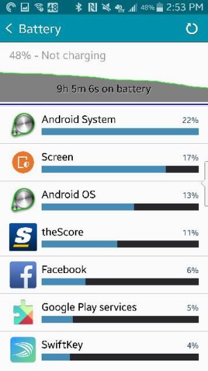

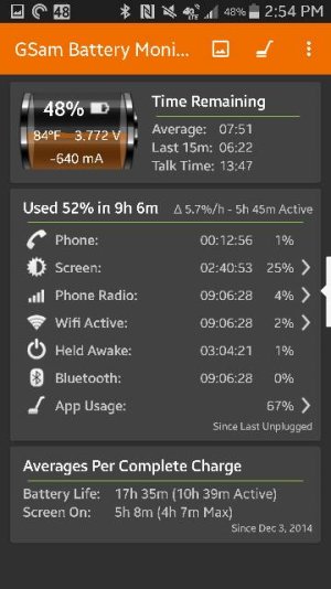

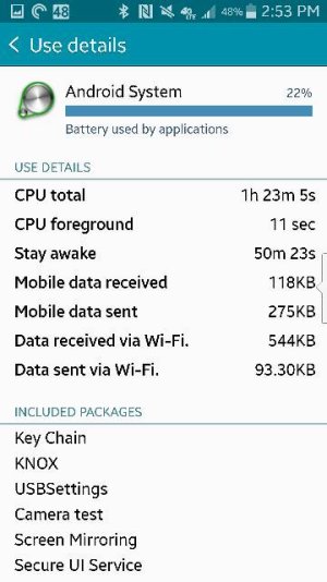

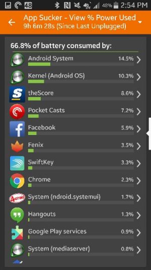

I'm not sure if this is good, bad or average?

Yes, that makes sense. And I looked...You can see each element in app-sucker and it'll take you to it to "manage" each one but they are mostly things you can't shut off and nothing really tells you which is keeping it awake. Have you tried the various lists of diasbled apps?

D/l wake lock this is most it will do without rooting. Really frustrated.... As for an average consumer and not techy of Android.... I'm feeling like I shouldn't have to do all these things to make a brand new phone work properly! Please don't get me wrong, as I am Extremely appreciate for the help!
