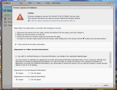

Hi
I am facing the same issue in my Samsung Galaxy S 3 from today morning. I have followed the instruction as you mentioned to firmware upgrade and initialization, but for me after step 11 "start upgrade" button is still not enabled in KIES3. Please help. Please see the screen shot of KIES3. Thanks.
Regards

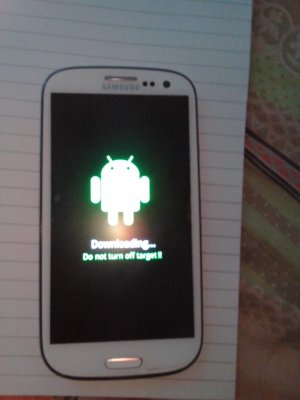

I also tried to perform a hard factory reset. but my galaxy s3 is not showing that option at all. I did
1. turned off mobile
2. hold volume up, home and then pressed.
3. then samsung logo came
4. next it was showing downloading... do not turn off screen. it did not show the factory reset option at all. Please have a look at screen shot of it.
5. I released power button, while still holding home and volume up, but nothing happened.

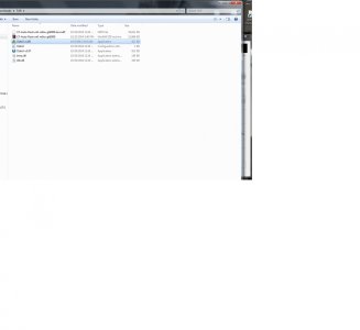

Hey Guys,
I am finally checking back here after such a long time. I have not been able to recover my S3 yet. I tried your method Meomonares but it will not work with both versions of Samsung Kies. I downloaded Odin and manged to flash a custom binary on there sucessfully. I get a green screen in odin and it reads " Custom Binary: Yes (1 count) in recovery mode. But when i reboot the phone it still remains stuck on the Samsung screen. I have cleared the cache etc but i am lost now on what to do?
Can anyone help?
Odin Mode
Product Name: GT-I9300
Custom Binary Download: Yes( 2 counts) - This is 2 as i tried it twice
Current Binary: Samsung Official
System Status: Official
I tried using 2 versions of Odin and both worked but yet i am still stuck on boot screen. This phone was never rooted before is that my problem?If Kies doesnt work and Odin doesnt work am i doomed?
