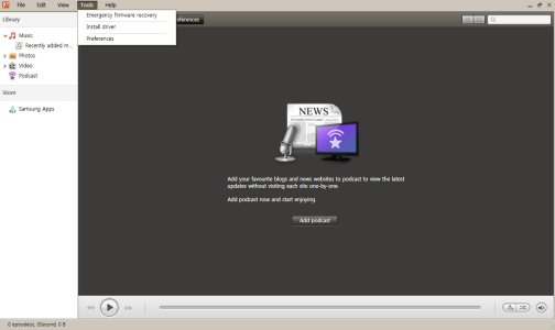

Hi,
I had the same problem, I tried to use the solution u offered, but I don't have "firmware upgrade" option in my samsung kies as u see in the image.
What should I do?
Thanks

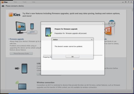

HI,
but after step #11 and i replace the battery and return it back and i press START UPGRADE , a message comes saying : this device's version cannot be updated.S3.jpg
* my phone is Galaxy S3 , i have installed Kies not Kies3
please help as i use my phone for business
Thanks

HI,
but after step #11 and i replace the battery and return it back and i press START UPGRADE , a message comes saying : this device's version cannot be updated.View attachment 119873
Thanks

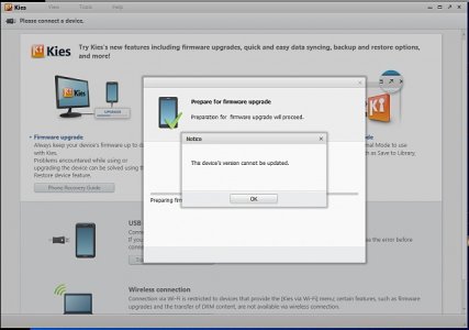

hi all, im having the same problem in my S3 GT-I9300, i have same screen appeared every time i try follow the stepsS3.jpg
