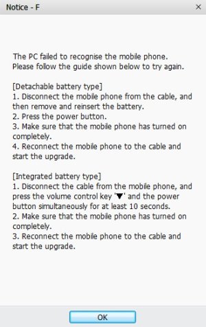

Hi I've tried the above method and get to step 11 and it stops working after the firmware has fully downloaded. It tried to upload on to phone but this is what happens: View attachment 110719
Please any help would be appreciated.
Thanks in advance

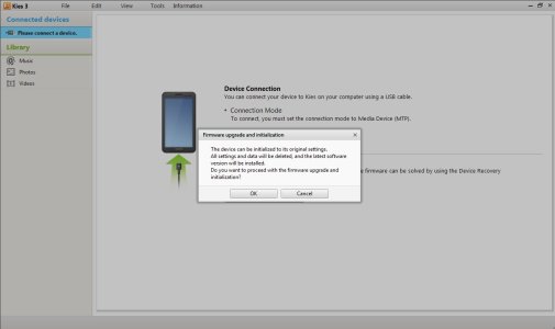

Hi I get past step 10 then this pops up
Is it safe to say yes and proceed or is this not part of the guide??
would it wipe out all my data ?
This is the pop up warning when using the firmware upgrade and initialization while entering the Phone in download mode.
To some users in this thread it didnt wipe their data. However, My experience IT DID WIPE EVERYTHING, but I did initially have a full backup before trying to upgrade from 4.1.2 to 4.3 (which lead to my phone being stuck in startup). So use this as last resort. I think flashing single file using odin would keep all user data, but I have not tried that.
The Kies restore process restored all except Call log, network settings, and the installed apps (and their data) Luckily I have all apks backed up.

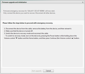

Is this thread still active? i tried your method but im stuck here.. the 'start upgrade' button is not active.
what should i do??
