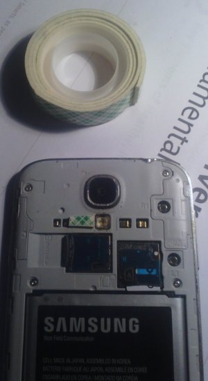

Hey all,
Just thought I'd post what fixed it for me. I tried most of the items suggested (cache clear, reset, paper in sim slot, bluetooth app?, etc), but as found on other sites what fixed it is pressure on the ribbon cable location.
You can see if this will solve your problem easily without taking your phone apart with some double sided tape (for thickness and easy application). You can see I put a small strip just beside the LED and it only creates a small bump on the back of your case. I've gone an entire week since the fix without the issue coming up again where it would happen about twice a day previously.
Hope this helps others!
A week now and still no Sim error. Earplug foam on the SIM connector plug really works.
Just have proper plastic tool to crack open the screwed in cover (after removing screws) so you don't damage it.
