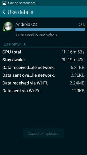

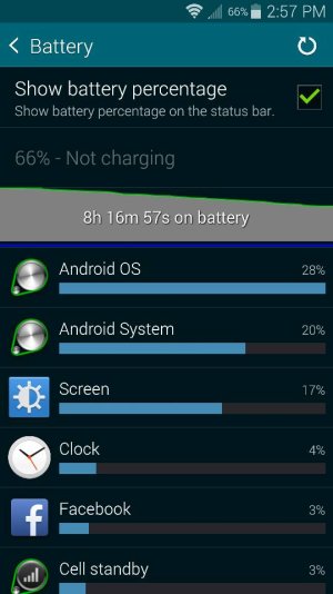

Frustrated because the usage is so high and I have no idea what's causing it to stay awake! uploadfromtaptalk1397501888581.jpguploadfromtaptalk1397501899512.jpg

Frustrated because the usage is so high and I have no idea what's causing it to stay awake! View attachment 112516View attachment 112517

This doesn't seem so great because something is waking my phone. This is not normal. :(

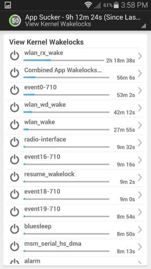

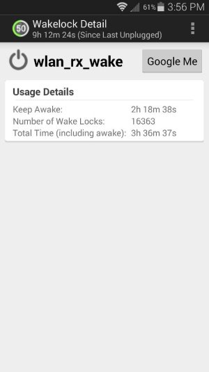

Ok here is what u have found so far as the major killer keeping my phone awake. Any ideas on a fix? uploadfromtaptalk1397508928529.jpguploadfromtaptalk1397508937339.jpg
I did Google it but it seems to be the wifi service and not the phone itself? I use different networks during the day and night so would turning off wifi be my only option here?

Also if you look into advanced setting under WiFi, there should be check box for searching WiFi points even when WiFi is off. That's standard feature of KitKat and turning off that option should be better for battery I guess.
Thanks! Changed my wifi settings to keep wifi on during sleep only when plugged in. Hoping it helps as I can't fiddle with the cities routers at work!

Do you need to be rooted in order to see the wake locks within that app?
