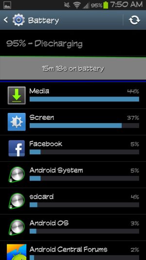

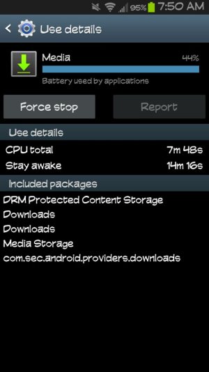

Thanks all for the input...its great that everyone here is willing to help....and waaaayy smarter than me....i took these this morning

He's got the media thing! Bad files on the SD card...

Did removing your sd card, as I suggested before, eliminate that problem for you? Has your battery improved?
I reformatted my card, remember? I've been fine since.. battery is "eh" like it always was.. lol

When you say bad files does that mean virus or just not compatible with j.b. ??

Take the card out and just watch your battery life. When you pull up the battery stats you probably won't see media as the first thing listed.

I mean something that just went bad... that's what a corrupt file is :)
