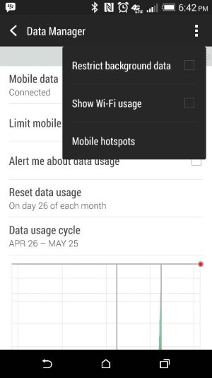

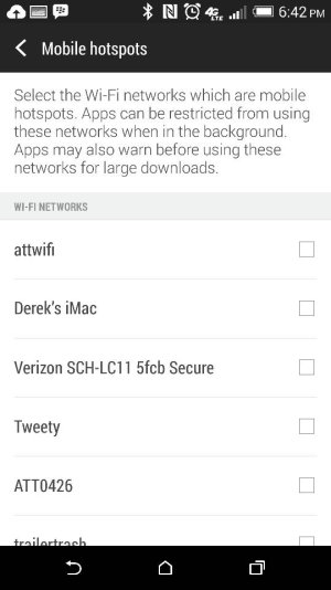

I found it! Data manager had marked every access point I've used as Mobile Hotspot. Unchecked them all and now WiFi only sync works.
Go to Data Manager hit menu then Mobile Hotspots. Checkout the screenshots.

So I think it does this since the last OTA enabling Extreme Power-saving mode.. Any new Wireless Networks I connect to are marked as mobile hotspots. Once I uncheck them they're never marked again. Only if I delete the network and reconnect is when it checks it again.
